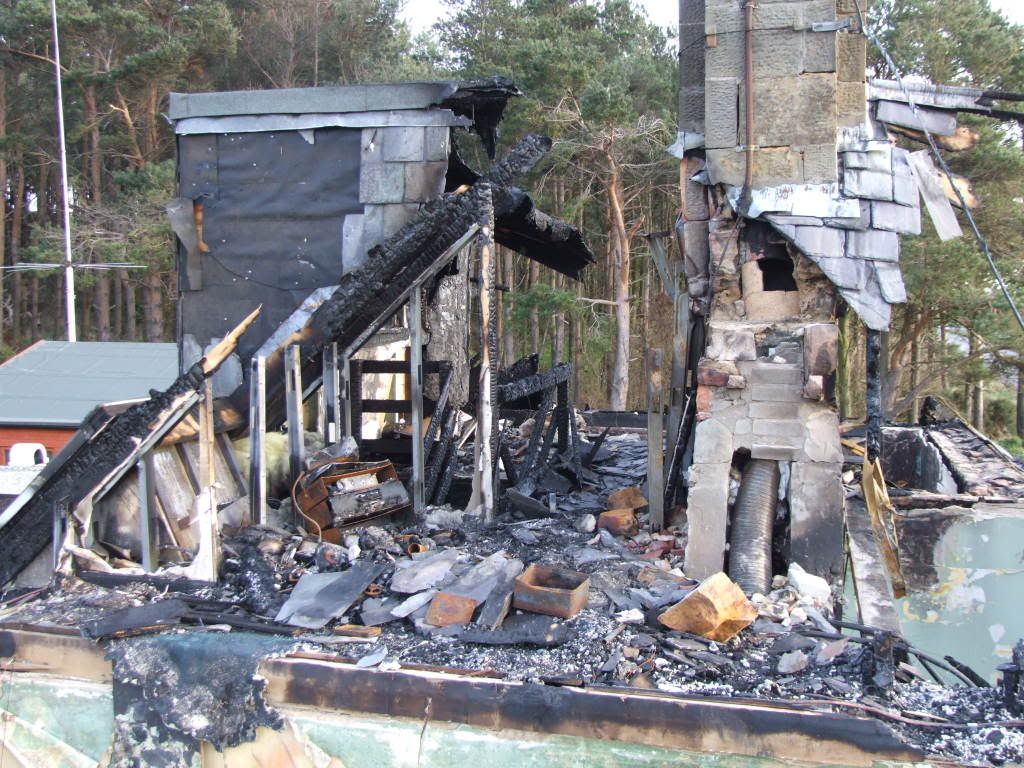

You can just make out my old Sirio 827 mast on the garage, after the house fire! Stolen 2 days later! :cry: :cry:

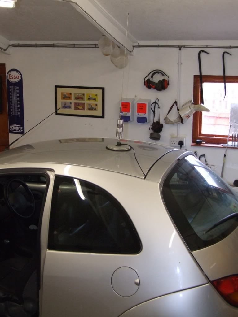

My 'towcar' CB set-up, a Cobra ST75 and magmount with an 'Orbitor' aeriel.

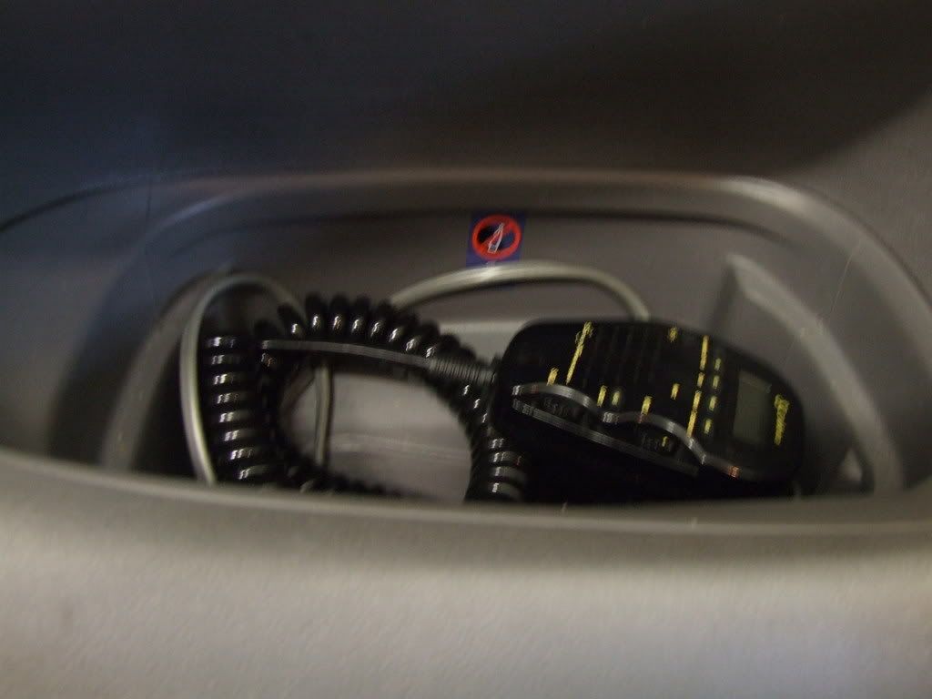

CB stows in the glovebox. Completely invisible!! 8)
'Orbitor' aeriel on a magmount, stows in the boot. Cable is fed through the headlining and again, completely hidden. 8)
