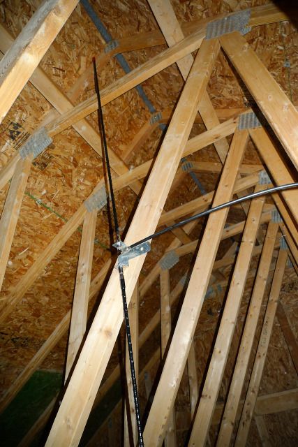

or mount it in the attic on a ground plane
