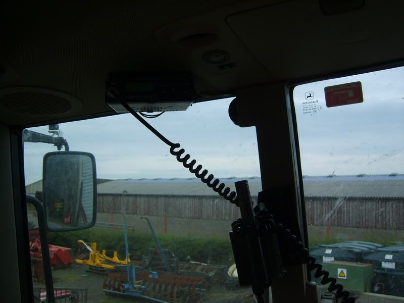

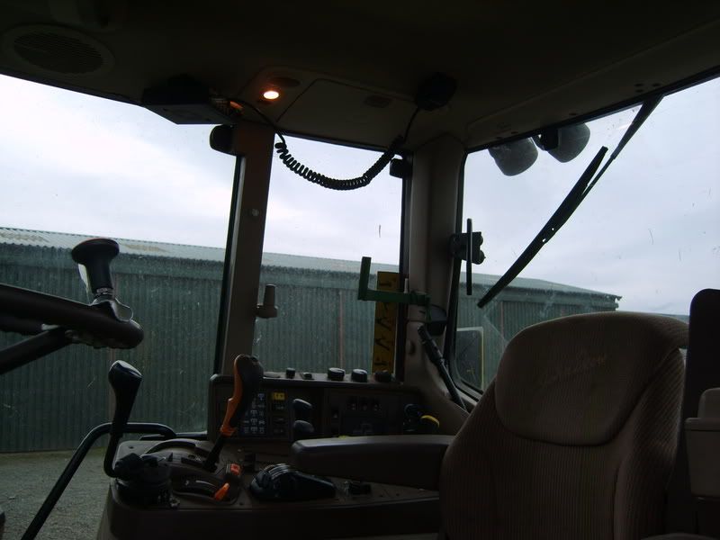

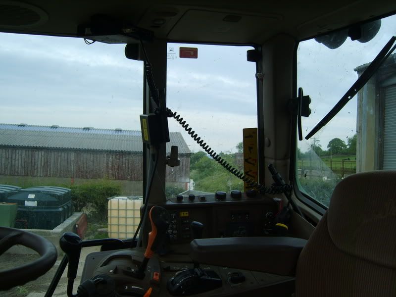

Here is some pics of my setup in my JD 6820 and JD 6920.
The JD 6820 had a TTI TCB 770 and ML 145 on the mirror and the JD 6920 has a midland 98+ and a SIRIO HY-POWER 3000 on the mirror.
I'm getting about a 8-10 mile radius with the 6820. Not sure how far with the 6920 as I have only recently installed them. More pics to come...

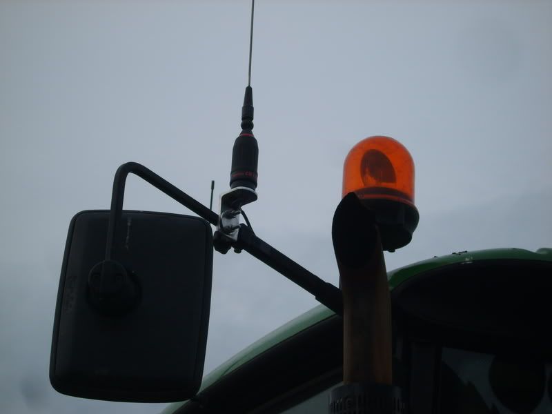

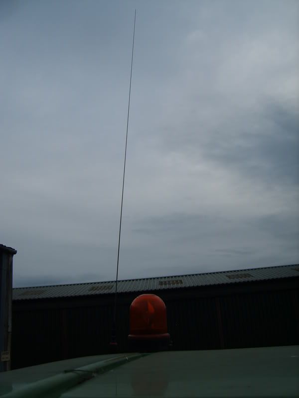

Here is a couple of pics of an install I did on my JD 6930.
I have mounted the Orbitor on an SO239, so that I can swop it to a Sirio Hipower 4000 for when I am working at a farm further from home. That sirio is very tall and so I use the Orbitor most of the time for when long range work isn't necessary. The mount is made from a John Deere beacon mount, screwed onto the normal position (through the mirror bolts) and then a piece of angle iron welded to it and the antenna mounted on that. Makes for a tidy job...

Yeah, we don't bother with twin beacons at our place, (still 1 on the otherside obviously)
and with the front mounted speaker it means all the work is done. I also think that I've got a pretty good ground plane with this mount setup.
going redo my JD 7810 this way, don't like the mirror mounts that much which I've always used in the past.
Chris
I don't know about this one, it had a spare DIN hole, so felt I had to use it...is john deere the only manufacture to have a proper place in the cab for a cb?certainly isn't anywhere in my massey
Chris

Hmm.... over the summer I have wrecked my 2 mirror mounts under trees as the Sirio HY-POWER 3000 and Sirio ML145 odes not give much way to trees.
The Sirio HY-POWER 3000 is currently mounted on the mudguard VIA a magmount just now.
I'm going to buy 2 5ft yellow springers for my 6820 I think as they seem to get on with trees a bit better
- Gordon

Antennae on mag mounts in my experience never work far. (cr*p grounding)The Sirio HY-POWER 3000 is currently mounted on the mudguard VIA a magmount just now.
I will have to see if my sirio gets beaten up by trees at next harvest, won't need them till then... so will continue with the springers for now.
Also antennae mounted on tractor mudguards don't do well because of too much metal from tractor cab, must be at roof height.
The other thing I found was that the mirror mount on my 7810 was somehow insulated from the rest of the tractor and therefore grounding was a problem. Also those aluminum mirror mounts corrode after a few years and the swr goes up and the grounding becomes poor. Have also found that the mounts with the coax pushed in the bottom of them rather than on a proper PL259 connector get corroded also and then water gets into the coax and the whole thing becomes a nightmare.
I recommend that once you have put the mount on the tractor (before fitting the antenna) that you use a continuity tester for checking the grounding. Just put 1 end of the tester on the mount and the other on a tractor bolt somewhere or on an exhaust bolt and if you haven't got continuity then your grounding is not good and the antenna will probably perform poorly. With the mount setup above the grounding is very good and I got good low swr.
Also check that there isn't continuity across the coax shield to the centre core of the coax after you've set it all up. I had this happen a couple of times when I was soldering the PL259 ends.
Another good thing to do when you think you have finished is to put the cont tester on the screw shield of the PL259 connector at the radio end, then put other end of the tester on a grounded bolt in the cab to see if there is continuity. If there is then grounding is good and that's a good sign. Then do your swring.
You've probably heard all this before, but it's a good way to check stuff.
Chris
