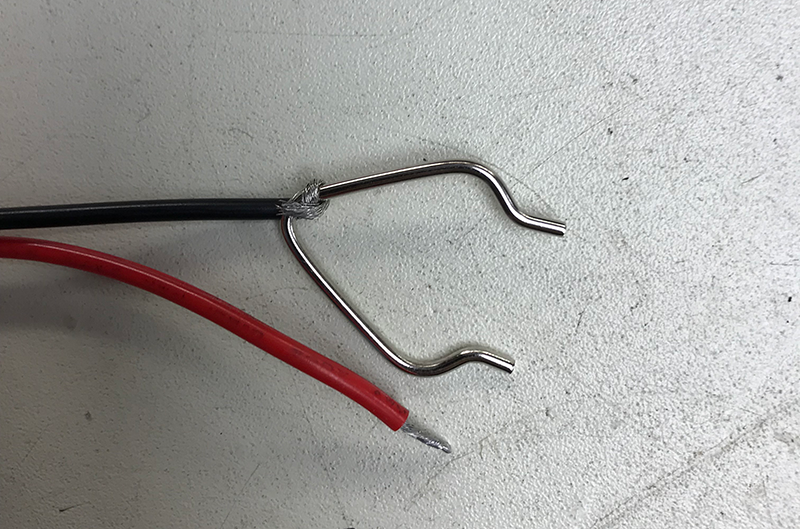

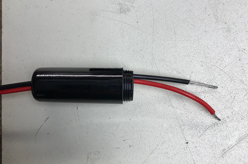

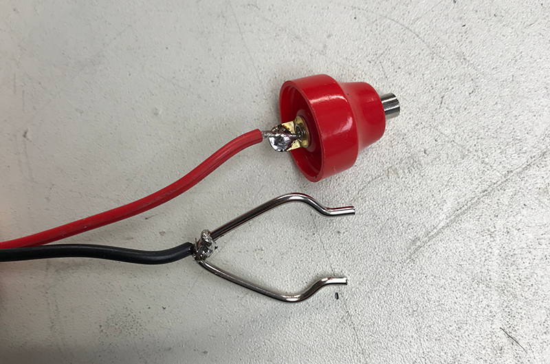

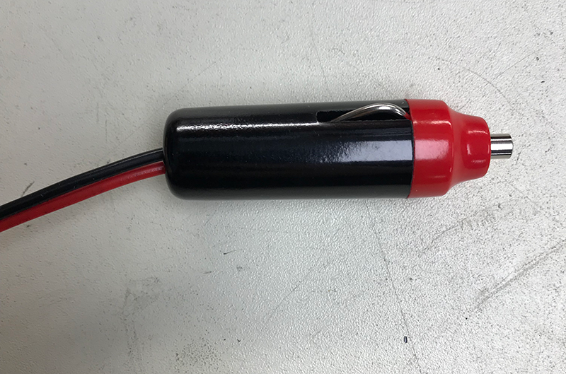

Instructions on fitting a solder on cigar lighter plug;
1) Strip back the insulation and thread wire through black plastic casing
2) Wrap negative wire around metal part
3) Solder on wires
4) Screw plug together
Posts: 6090
Andy Should have looped red cable through hole in connector before spoldering buddy takes the srain when pulling out of the socket
