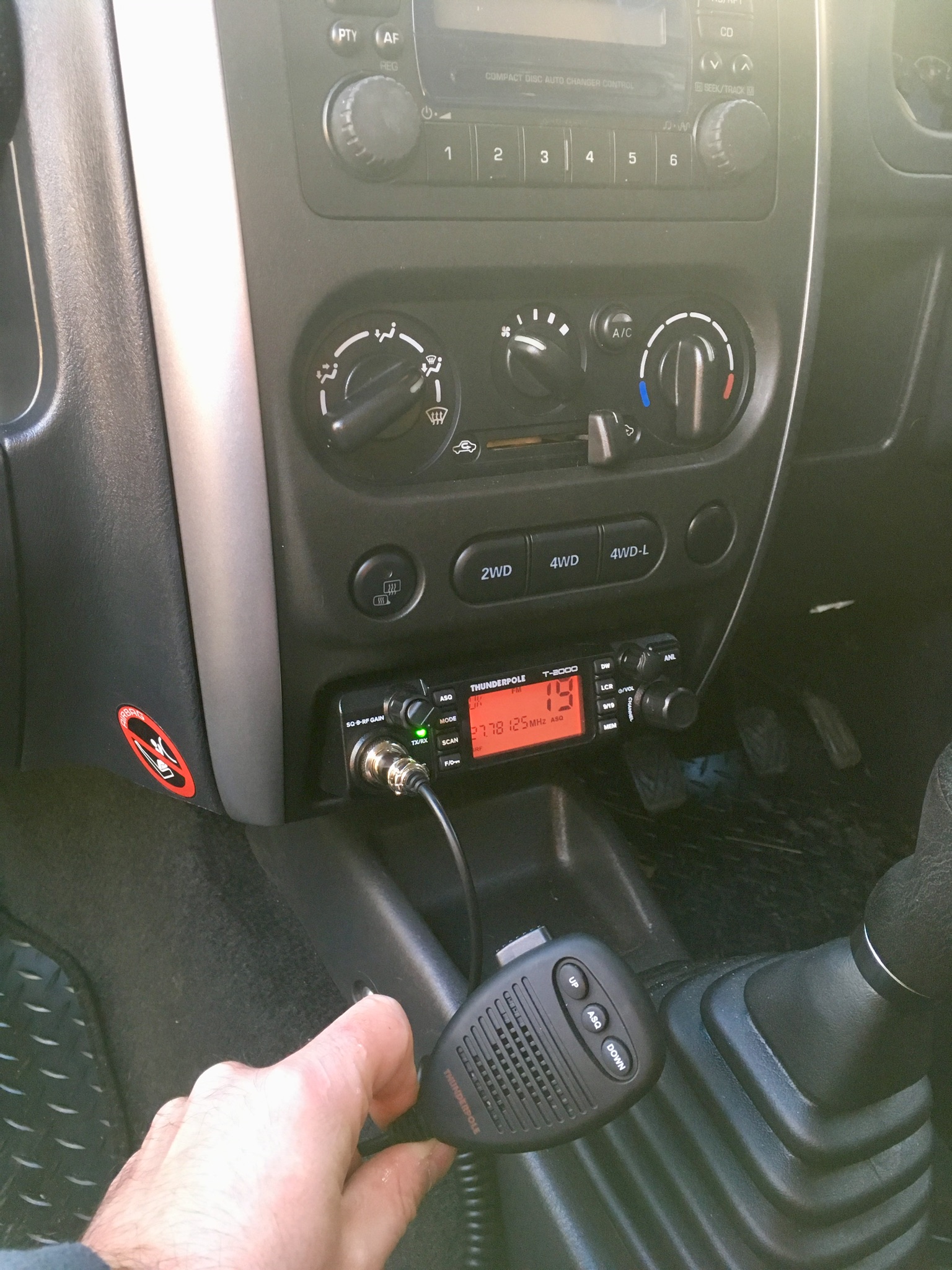

I went to great lengths installing a Thunderpole T2000 into the dash of my Jimny, and a through-the-roof mount for a Sirio ‘Blue Line’ antenna. The headlining had to come out, the centre-dash had to come off, and I had to cut away the cigarette-tray.
Well worth it, though....
