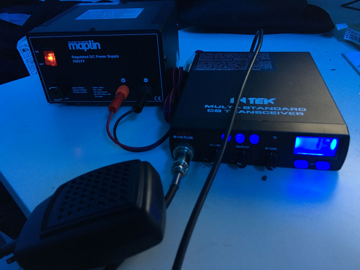

I'm completely new to the world of CB radio and bought my first kit a couple of weeks ago.
Good to find this forum and see there are still active users. Nice to e-meet you.
I don't know if this is necessarily the place to ask for help, but thought I should kill two birds with one stone. So straight away, I have a question for you all: what am I doing wrong with my CB? :)
I'm attaching a few pictures of my gear, an Intek transceiver connected to a (other company) antenna at home. The radio turns on, but only static comes out on every channel, as if the antenna wasn't doing anything...
Cheers!

the antenna looks wrong but if it swr's ok the it should be stood vertical not lying at an angle

I tried putting it completely vertical but unfortunately nothing. What do you mean exactly by "the antenna looks wrong"?
Thanks.
Posts: 6090
i presume you have had a swr meter on it to check it it looks very short for a half wave to me

Unfortunately I don't have a SWR meter to check.
I can make the antenna longer (it is 5 metres max) but it obviously won't fit my studio. I guess I should get a more appropriate antenna and return that one?
Posts: 6090
yes would be a plan but invest in an swr meter as they are worth there weight in gold

It looks to me as though the original antenna didn't work as it wasn't extended to the correct length.
Every CB antenna is designed to be a certain length, and it is critical that the length is perfect (to within a few mm) otherwise it won't perform.
As Stampman says, an SWR meter will help, as it will tell you whether the antenna is performing well or not, and if it isn't you can adjust the length slightly until it is.

I'll look into getting a SWR meter asap and an antenna I can extend to the appropriate length.
I foolishly assumed you could extend it to whichever length you wanted, and that it would simply perform less well at smaller lengths.
