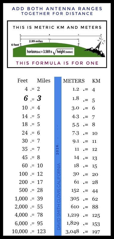

Here is table for line of sight
Remember Citizens Band 11-meter you add n Groundwave propagation Apx 19 miles for ¼ wave antenna {102 inch wipe } and larger
1) Line of Sight chart-01-02.jpeg (142.24 KiB) Viewed 17171 times
